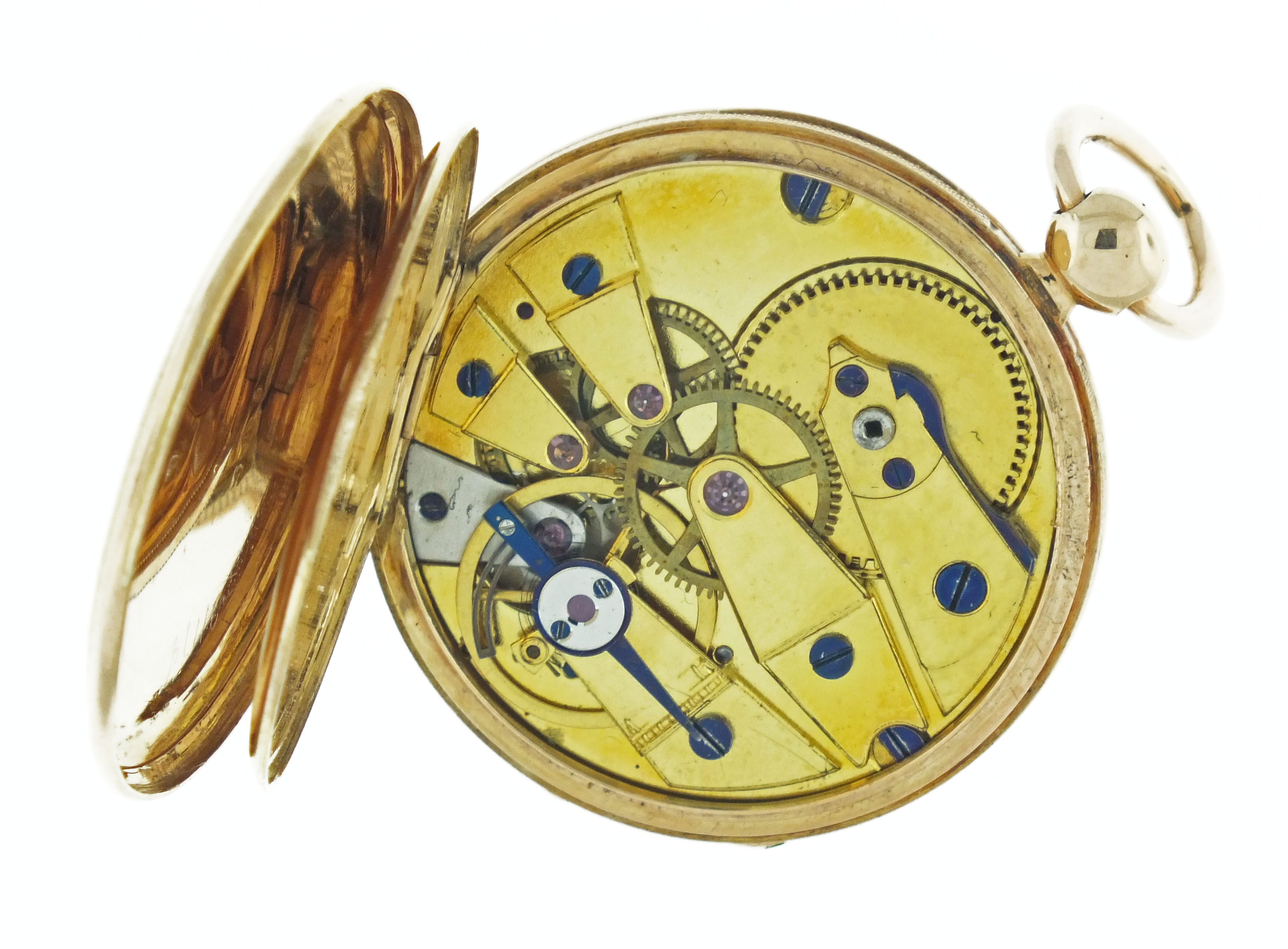

I just received the watch I purchased in the recent J&H sale.
With the parachute and compensation curb with the nice large size, I felt I needed to have it at a reasonable price.
In looking at it the escape wheel and balance close view shows the back of the dial behind the escape wheel. If this is a ruby hanging detent and if I were Bernhardt, I would need to return it for having paid too little.
Can anyone tell me how to determine the cylinder type withouot disasembly? Here is the link to the watch in the sales results. Charles Oudin, 53mm, 18K, cylinder w/parachute | Jones and Horan Auction Team

Hi Tom,
This appears to have a perfectly standard Swiss cylinder escape wheel. All the Breguet cylinders I've seen, (but regrettably never actually handled), have had a rather different escape tooth form, more of a broad wedge than this 'tenterhook' pattern. Since the vendor's pictures understandably don't include a view with the dial removed, that's the only clue available.

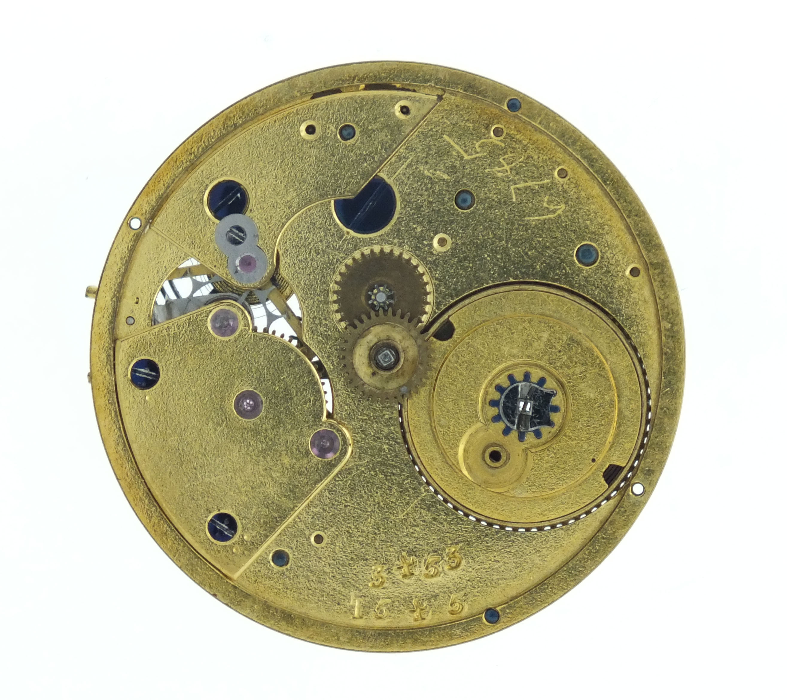

The Breguet ruby cylinders are very distinctive.
The lover pivot of the balance is in a very thin potence. The ruby hangs below it and the escape whee tooth reaches up. Never having seen one in the "metal, I can't comment on how visible they are but I have seen photos that show the arrangement
There was another form.
This is from the Schmitt Horan site:
here is the couvette
If yours looks like this it, is not the Breguet type.
Most significantly if it has or had a ruby cylinder it would probably say so on the cuvette.

Thanks Jon,
Your third picture clarifies what was confusing me. I did not relize how open the pllar plate would be on a "normal" French cylinder so I was confused when I could see the back of the dial under the escapement.

Hi Tom,
They aren't open like this as a rule, but this maker clearly had a reason for leaving that opening, possibly to make it easier to observe the escapement.

As Dr. Jon said, the escape wheel is situated well below its usual spot, so an especially sunk escape wheel and cock is one tell. In a number of photos of Breguet movements that I've seen, it's difficult to see the escape wheel at all. As well, while this is not universal, it's not uncommon for Breguet overhung escape wheels to have somewhat fewer teeth. Lastly, the only other maker on whose work I can recall seeing an overhung ruby cylinder was Leroy, and only once at that.
